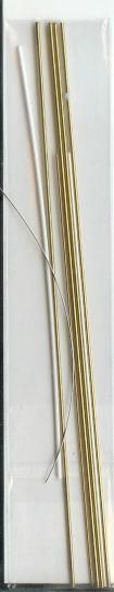

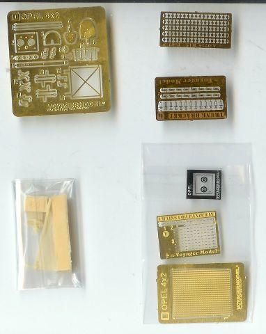

The kit consists of three large frets of Brass , five smaller frets , film for the guages , a resin Pick , a resin Notek , 4 pieces of 1mm brass tube for the Canvas hoops , a piece of .5mm brass tube , a piece of .3mm steel wire , a piece of 1mm plastic rod , a piece of .5mm plastic rod and two pieces of 95mm x 105mm x 1mm Plasticard !

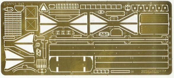

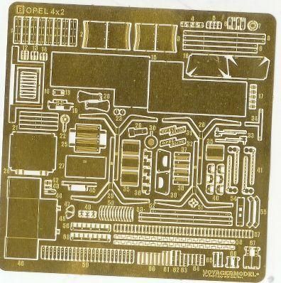

So what do we get ? Well starting from the front we have a choice of two Opel Blitz emblems for the front grill ,a full new notek & mount , new headlight mounts , new tool fittings for the shovel including a new shovel head & a full resin pick & fittings , a penant frame , new width indicators & an entire new bonnet & catches .
Moving to the cab , we have replacement door handles for interior & exterior , replacement rear view mirror , wipers & spot light mount , the sideboards have new replacement anti slip plates , Jack fittings & replacement handle . Internally is a new dash panel, new brake + accelerator pedals , a traffic marker with holder for the door & a new rifle rack .

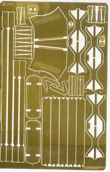

The full rear tray makes up the bulk of the build , replacing the full Tamiya rear tray completely ! Unfortunately it is in this section that the big dissapointment with this update is , what appears to be either a resin or perhaps wooden tray for the cargo bay is plain ordinary unscribed plastic card ! So comes the big dilemma with the kit , do you throw the Tamiya cargo bay sides & scribe the individual beams , then add the wood grain ? Or do you sand the fittings off the Tamiya parts , fill the sink marks & the ejector pin marks , while re-adding the texture of the wood ? Or do what possibly Voyager should have done & try and source some basswood or similar in 1mm width ? There is of course a fourth option , which will make maximum use of the Voyager set & model a burnt out wreck !
Back to the set , beside the plastic card panels , everything is included , the supports for the trays chassis , all three tool boxes in brass , the jerrycan holder , convoy light & number plate , guard mountings & mud flaps . The metal frame for the bed , indicator paddles , hinged sideboards the fittings for the canvas hoops , both stowed & upright & the tiny tarp loops are all there . The fittings to lock the sideboards & the tail plate are included including the fold up steps.
