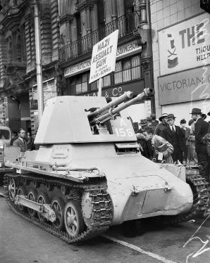

I was hoping that through some shrewd detective work I may have been able to photograph one . I came across this picture
A captured Panzerjager I that was brought to Australia & was brought to Australia with an Italian Carro Armato tank , the picture here is in Flinders Street , Melbourne , Victoria . The tanks toured with the War Bonds rally .
The official history was that the vehicle was disabled having its transmission damaged (note the patch applied here in Australia ) . I am not sure of the validity of the markings .
Unfortunately like so many other World War Two vehicle this was sold for scrap metal along with the Carro Armato Crying or Very sad !
