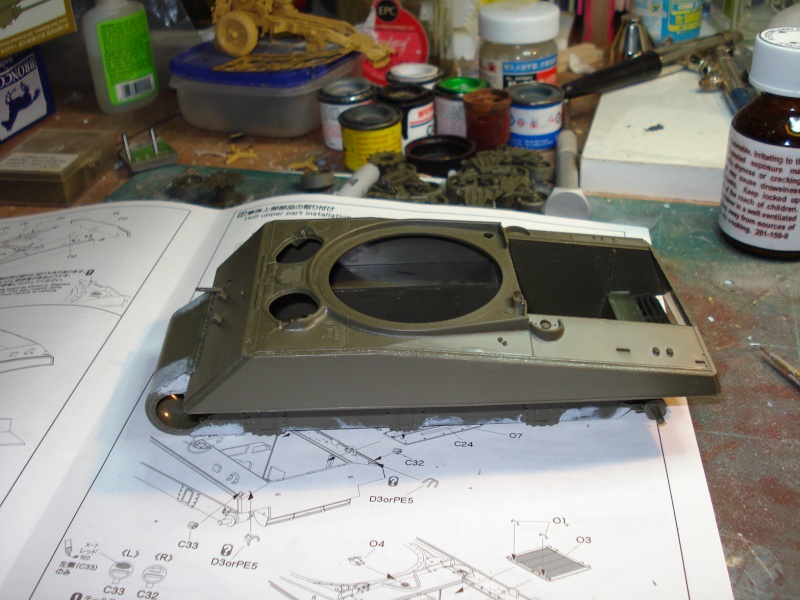

The next steps was to construct the details, the FDA and the upper hull. These all went together very easily, the only issue being the ambiguity on parts B13 or B14 to use. Tasca thoughtfully provided all the parts to depict the tank with the FDA removed for work on the transmission, but they don't indicate this on the instructions. So far this has been their only DML moment. Everything else is very Japanese in precision, with parts poke-yoked for fit and location. Toyota would be honoured by this adherence to their principles.
Some Mr Surfacer is needed to recreate the cast texture that gets removed during clean up, but otherwise the filler has remained in the drawer. Might need to use a little bit just to tidy up the welds on the additional armour panels though.
