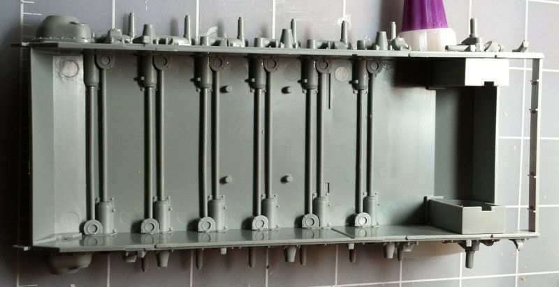

'Twas a slow weekend at home so I got a jump on my F1. This is my first StuG III model so please be gentle in pointing out any noob foul-ups Smile
I skipped Step 1 of the instructions as it simply covers the road wheels, drive sprockets, and idler wheels.
Step 2 begins with the insertion of all the torsion bars and accompanying caps. Not sure why I spent a lot of time on these as they won't be seen once the hull is attached. They do look cool, though! tongue
Step 2 also covers the various suspension arms, stops, etc. and Step 3 the first steps on the rear hull which is constructed separately and then attached. Step 4 was skipped as it calls for the attachment of all the wheels from Step 1. Smile However, I did attach the final drive covers and track tensioning apparatii to the hull. Here are close-ups of some of the detail from both the front left and the rear left:

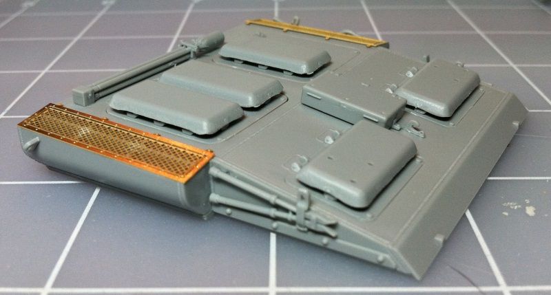

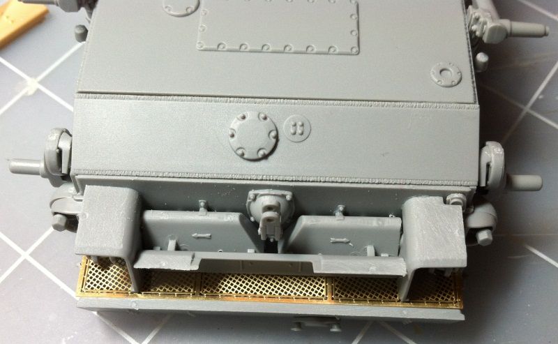

Step 5 finishes construction of the rear of the hull and pulls it all together. Here are shots from above and below:
All in all, I'm very pleased with the detail in this kit so far. cheers

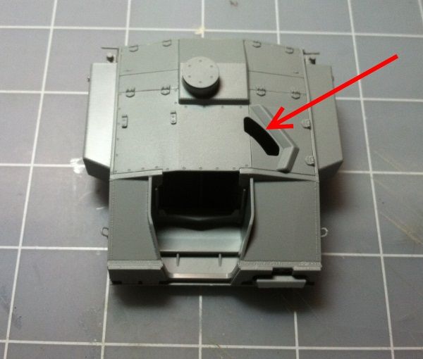

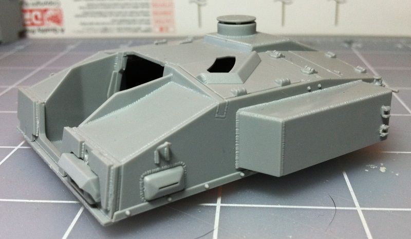

I ran across an issue when constructing the superstructure on my (F1). There is an arc-like opening in the roof, shown by the red arrow in the pic below. The instructions show no part to close it off and I've been through all the sprues checking and see none, either. There does appear to be some sort of wire cage included to go over it (as an option), but it would still be somewhat open. I have seen no pictures of this opening in any of my sources, nor any pics of the installed cage. I thought it was for a periscope, but the scissors periscope protrudes through the hatch to the rear of this opening. Can anyone tell me what this opening is for and if it should be closed off, and how? Question Question Question
Thanks!
Mark
hmgroth
Posts : 235
Join date : 2010-11-10
Age : 70
Re: Stug III (F1) - Mark Groth
Post  S P Hammerton on Mon Nov 19, 2012 9:53 am
Hi Mark
That slot is for the Gunners periscope sight, which is a different device to the Scissors telescope used by the vehicle Commander.
Post  Jenny Ryan on Mon Nov 19, 2012 1:43 pm
Thats right , what Simon says , let me have a look through my references for some piccis Very Happy

Hmmm... that's quite a problem you have there. I can think of three things
Fit the gunsight in there anyway as the flame projector would require some sort of aiming even at the short ranges that it would operate at.
Plate it over with a badly welded and colour mismatched piece.
Trawl the net and references looking for photos of de-gunned StuGs and use those as a starting point.

Post  Jenny Ryan on Tue Nov 20, 2012 3:52 am
The cage was used to protect the site , it was only attached to the gunners hatch and not the hull . I will try and scan some more info this afternoon . Very Happy
Post  Jenny Ryan on Tue Nov 20, 2012 4:11 am
Well I have only found one photomagraph ot the flamethrower variant and it does not appear to have the sight nor the cage fitted , I would say the gunners hatch would still have the hole and as 10 of the vehicle were made I would suggest that a patch would have been welded over it under the gunners insistence Very Happy .
StuG (F1) Sight Opening Thanks!
Post  hmgroth on Tue Nov 20, 2012 10:14 pm
Simon, Andy, and Jenny, thanks to you all for the valuable information re the sight opening. I did more research and came up with what you all suggested. It appears on the earlier models there was no opening. Then there was a rather large opening, followed by it being somewhat closed down on the later models to the "slit" that we see here.
I found the one photograph of the (F1) [Flammpanzer German Flamethrowers, 1941-45, Osprey New Vanguard No. 15] and since the photo is taken from a low angle one cannot see much of anything on the top of the hull. The same book has an artist's rendition of this vehicle and it shows the opening as just a black hole! So I can see why the kit doesn't address this point at all.
I've decided to go with the suggestion to just place a field-installed welded metal plate over the opening. Problem solved (but what actually went there will continue to bug me).
Oh, and I found no photos of any StuGs with the "cage" cover over the sight. I'd swear that I've seen one before, but can't find it now.
Again, thanks for your help! cheers

Post  Andy J on Wed Nov 21, 2012 12:09 am
Glad to help, albeit in a somewhat limited and inconclusive way.
Must admit my preferred option would be to plate the embrasure over, especially considering the paucity of photographs of the vehicles in question. But like you Mark, I will be forever bugged now with the question as to what actually went there...
Also, just like you, I'm convinced I've seen photos of the early StuGs with the gun site covered in mesh screen. No idea where of course so this is yet another mystery that will niggle at me, much like the oft quoted but never subsequently seen photograph of the Thunderbird taken in the in the late 1800s after it had been shot by a hunting party.
Post  G Cooper on Wed Nov 21, 2012 6:09 am
Hi Mark:
That is really a nice looking model. And the good vs evil of the gunners sight is that if there is no reference to say one way or another is that you can do what ever you want, and if someone says it is wrong, ask them to produce information disproving what you have done. So long as it is reasonable it should be good to go.

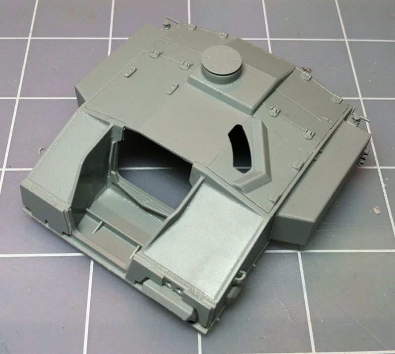

Well, I've mostly completed the upper hull and several issues/questions have arisen, naturally. Let's take it one section at a time.
Here are three photos of the main superstructure. Note that the antennae have not been added nor has the gun sight slit been plated off. No real problems with this section Smile

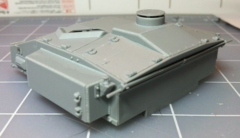

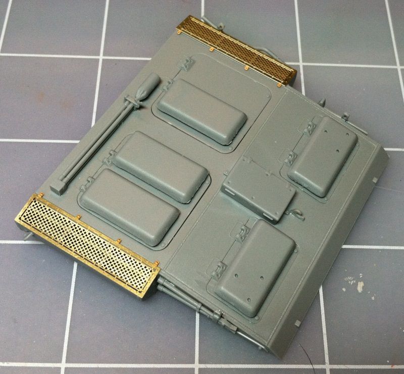

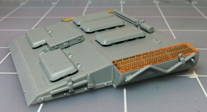

On to the rear deck. The main issue here is the six holes (three each side) on the rear-most covers. These are obviously meant for mounting the extra road wheels shown in the photo of the actual (F1) but, although the instructions show the parts with the holes, no call-out is made nor shown for the road wheels themselves. A search of the extra sprues included with the kit turned-up the missing brackets and wheels and they have now been mounted. Problem solved cheers

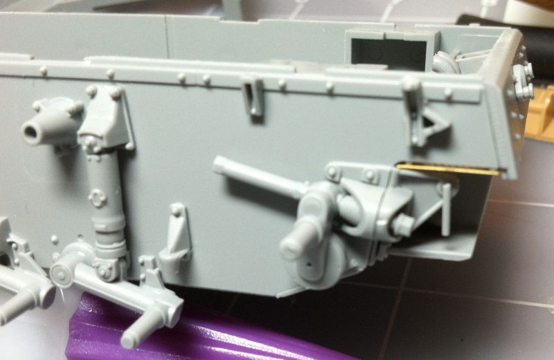

Off to the very front of the hull. You'll notice two things in the photo below. First, there are two MAJOR indentions on the top angled plate. This plate should be smooth so I'll need to reach for the putty later. Second, the lower angled plate has NO plate. The sole surviving photo of the actual StuG is under-exposed in that area so it is not possible to see if a plate went there, or not. The instructions and box art say "No" but I'm not so sure. That would leave a nice soft spot for enemy projectiles to find the enclosed fuel. A plate is included on one of the additional sprues so . . . decision delayed for now Smile

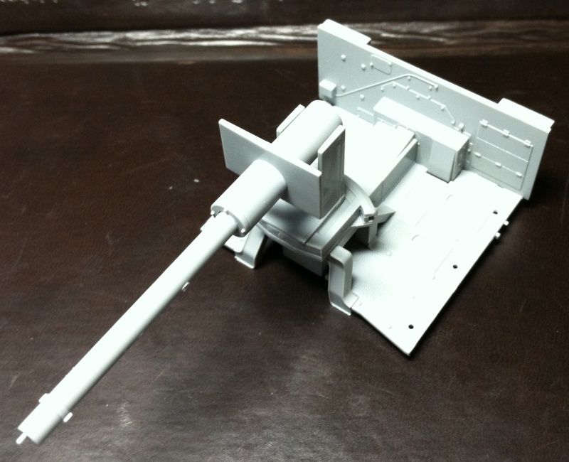

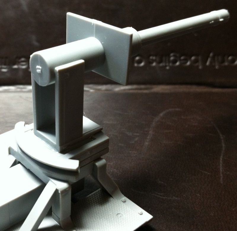

The flame thrower itself. Hmmmmmm. Here's where it gets interesting. The parts included for the support mechanism bear no resemblance to the illustration in the instructions in either shape or size. Additionally, the roof/cover for the flame thrower was produced in PE with some wicked compound bends. After dry fitting the flame thrower mechanism to the superstructure I'm not sure the roof will go on without some major surgery to the mount. I think the only safe course at this point is to scratch build the roof out of thin plastic card prior to attempting all the bends. Here are some shots of the interior, mount, and flame thrower. Note that none of the seams or attachment points have been cleaned-up yet.
That's about it for now. As usual, all comments are welcome!

As far as the little speed bumps, it looks like you have most of them covered. The only one that I see you may want to think about is the front plates. In the first photo you show with the two big holes, those were for a set of lights that were mounted over the brake cooling fans. But they were deleted for the StuG FI. The one photo I have seen of the flamm variant shows these gone, and a fairly thick steel plate over the entire upper front glacis plate. It is a little set back from the front plate so it would still show those weld beads on the very front top area of the glacis. And there was a single light set in the center of that front top plate. So you shouldn't need any putty. Just a piece of sheet plastic cut to size and glued over the whole plate, thus covering those holes, unless Dragon actually has that part somewhere in the box, but it is just not shown on the instructions (a very real possibility with the terrible QC of Dragon instructions these days)Smile . And as for the very front, it does indeed look like there is a piece that is not on your kit. I believe that there should be a plate on the very front that meets flush with that weld bead on the upper plate.
Post  Andrew C on Sat Nov 24, 2012 6:58 am
Mark, use part number D11 on the lower hull. This part is omitted in my F/8 instructions too.
For the top plate maybe use part D10 and shave the bolt detail off?
