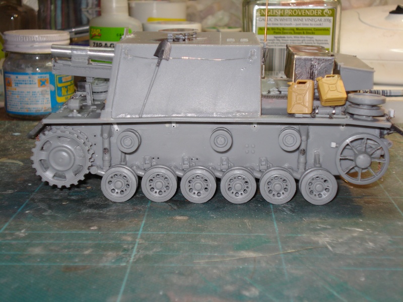

It had to be done and I could procrastinate no longer, the roadwheels, return rollers, idlers and sprockets have been assembled, cleaned up and dry fitted to the hull. It's starting to look like a tank erm... big armoured box mounting a BFG all bodged onto an overloaded tank chassis Razz
I'll start with the wheels first and then work my way round clockwise.
Did my usual of pairing each wheel up and then cleaning them up, makes it easier to hold onto but probably doesn't save any time as each one get the treatment. I use a big old file for this and I'm none to gentle either as the accidental nicks and cuts that inevitably occur, rather nicely duplicate the damage that the tyres would have suffered in use anyway. Each wheel has a really thick sprue attachment to remove and a heavy mould line on the outside edge, usual stuff to be expected. The alignment of the two halves isn't brilliant as the lightening holes don't line up. Difficult to tell from photos but I'm sure that they're meant to Suspect Anyway, you need them to line up as they need to be drilled out to remove flash or in the case of the smaller ones, to open up the odd one or two (several tbh).
Next is the sprocket, only two attachment points and very minimal mould lines all of which are easy to clean up. There's a bit of clean up needed when the two halves are joined but not too much as it can't be seen too readily. But once again the alignment is out, Dragon have three little locating pins so that the sprocket rings line up, trouble is the spokes and cutouts on the two halves don't line up and from photos these should Evil or Very Mad I removed the pins on one set but this really was a nightmare in trying to get everything lined up again, as without them there isn't any lateral locating either so the two halves just slide all over the place whilst trying to line them up. So for the second sprocket I followed the instructions and parts locating whilst cursing Dragon for doing a 1/4 arsed job.
Return rollers have similarly thick attachment points and a big mould line. Gentle clean up this time as they don't get knackered like the roadwheels. Dragon's little "gift" on these is the knockout pin mark in the middle of the hub. Yes really. In between the bolt detail. Shocked This required some very gentle carving with my micro-chisel.
Finally the idler, these need the most clean up as there are four knockout pins in between the spokes which leave huge nubs of plastic to remove all whilst trying to preserve the profile of the spokes. At least these parts line up nicely even if each one does seem to take an age to clean.
That's it, rant over.

Finished! Well I've finished the construction of the vehicle and fitted the wheels using blu-tack so I can form the tracks. Still to do are the tracks, the stowage, some sort of base and a figure. But after a lot of scratchbuilding, modifications and just good old fashioned modelling here's my first StuiG 33, gun G4 of 23 PD at the battle of Kursk.
