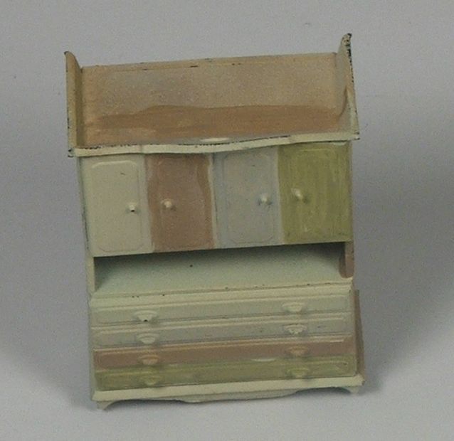

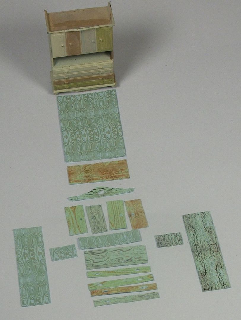

The first step was to paint the assembled cabinet , undercoated black and then painted with Lifecolor Paints , colors range from Dust 1 to Desert Pink , as you can see the paint job does not need to be neat

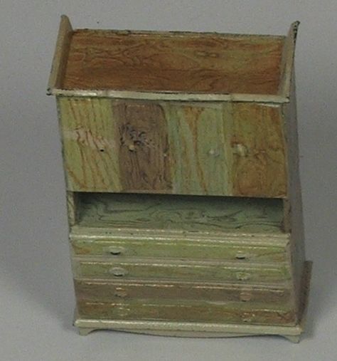

Next was cutting the wood grain decals , I used a variety of patterns and colors and used the darker grain on the darker colored paint .

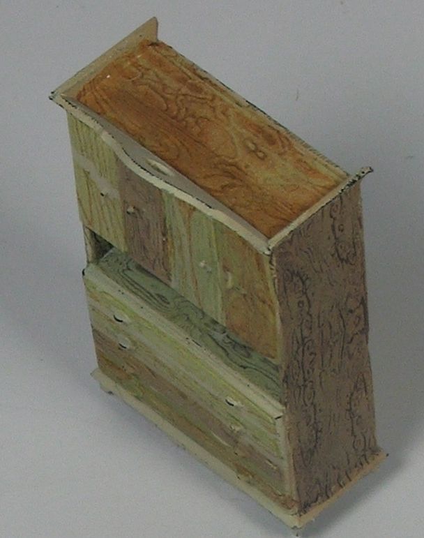

Next the decals were applied to the front of the cabinet ,

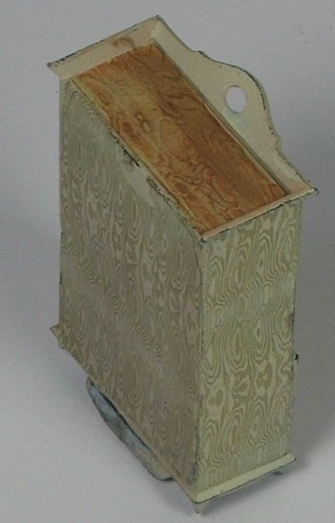

and back . You will notice that the decals have broken in a few locations .
After touching up the broken decals with a fine point brush it was time for the next bit .

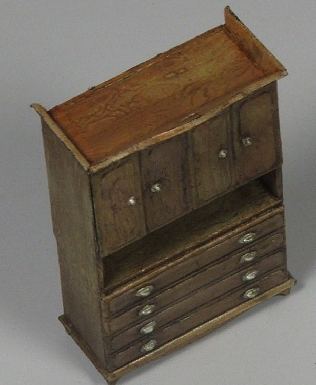

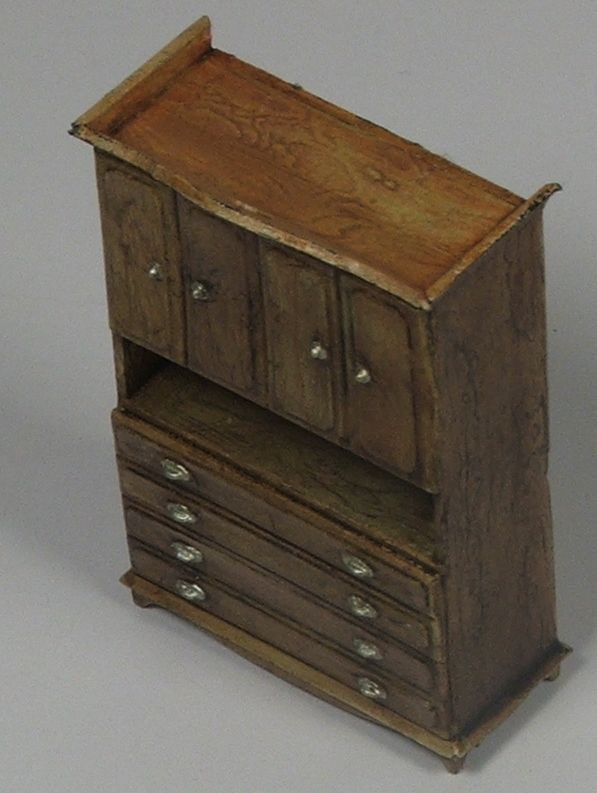

Next I added fading with Burnt Umber oil paint on the front panels , the fittings were picked out with Gunze gold paint .
The top of the cabinet which will eventually be dustier than the rest was faded with Burnt Sienna

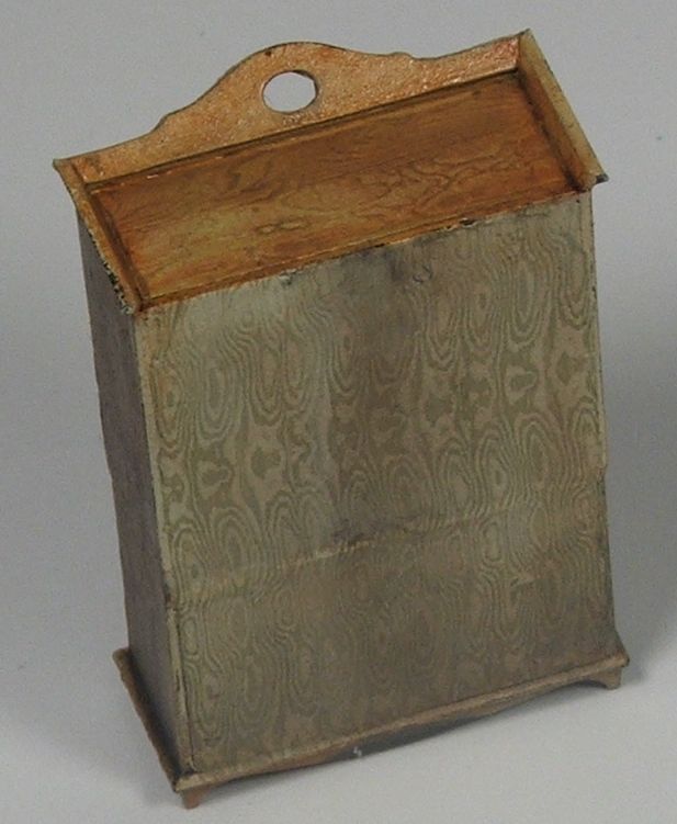

And the back of the cabinet which is represented as unvarnished timber was airbrushed with some Lifecolor Tensachrome Earth to add a subtle variety in timber shade & faded with some buff oils .
Well I think you can see that the Uschi range of woodgrain decals gives amazing finishes to this simple furniture piece . I really think it lifts the look of this piece amazingly .
