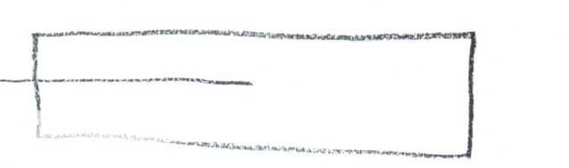

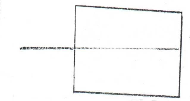

Step seven: Cut floral tape approximately 3 inches long. Place the wire (centered) on the tape approximately halfway down the middle of the tape (leave the wire a little bit short of the halfway mark). Fold the tape over onto itself. It will stick to itself but nothing else. (Now you should have a square of tape with a stand of wire sticking out of the center of it). (See figures 5 & 6).
Step eight: Take the scissors and trim the tape to the desired shape of your palm frond. Now cut notches in the sides of the palm frond, making sure that you don't cut all the way through into the wire. (See figure 7).

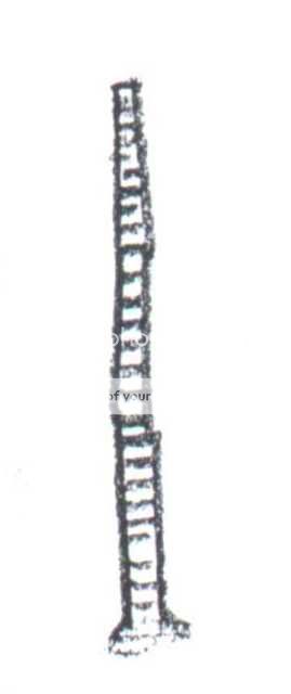

Step twelve: After the paint is dry, take the tree and roll it in the notch of a pair of scissors. This will give you the growth rings that show on the palm trees. Make the ones lower on the tree wider (spaced apart) than the ones closer to the top of the tree. (See figures 3 & 4).

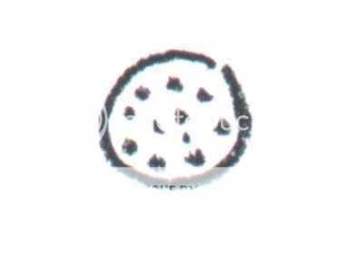

Step fourteen: Take the pin vice and drill out holes in the top of the tree. If you are ambitious, you can even drill a few holes diagonally in the side of the tree right near the top to add more palm fronds. (See figure Cool

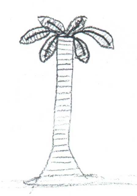

Step sixteen: Super glue the wire in the holes. (I always start with the holes farthest from the center, so the top most palm fronds cover the wire of the ones closest to the edge. (Make sure that you use the longest ones closest to the edge or down the side, as they would be the older ones and shorter ones closer to the center, these should go from left to right and so on to cover the other palm fronds). After the super glue dries, you can bend them into the shape you like. (Since the palm fronds have wire in them, they will hold whatever shape you put them in). I try to place 7 to 10 palm fronds in the top of each tree. (Use more if you are planning to drill in the sides). I always make extra palm fronds as you might want some placed on the ground.
Step seventeen: You can give the palm fronds a coat of paint or leave them the natural green color. I often give the palm fronds a black wash to blend them with the tree.
This (palm frond method) can be used for ferns also. I use the 1/4 or 1/2 inch floral tape for the ferns that are also on the jungle floor.
You now have a finished tree. (See figure 9)

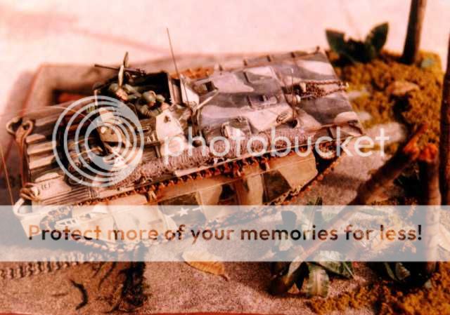

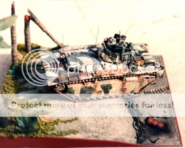

Here is an old LVT Dio that I did for the USMC (Currently on display at the AMTRAC
Museum at Camp Pendleton California.
Enjoy and Happy Modeling.
