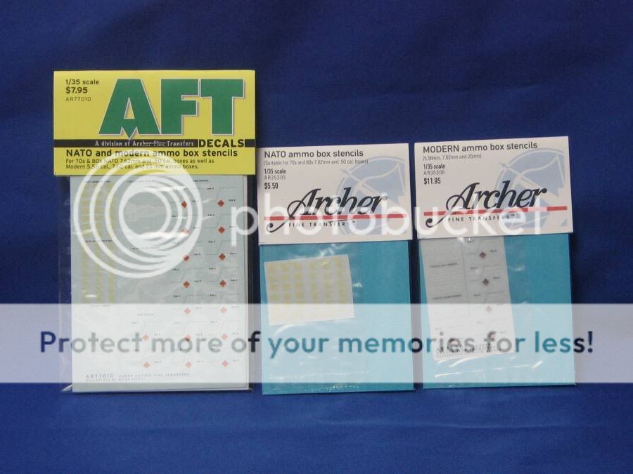

AFT decals is a division of Archer Fine Transfers (note the acronym this name makes?). They will strictly be water slide decals and are good news to many which are uncomfortable or unable to afford dry transfers. The decals are VERY nicely done and represent a good value.
The photo shows the water-slide decal on the left with the two relevant dry transfers on the right. For $7.95USD, you get the equivalent amount of markings as $17.45USD of dry transfers!
The black on the warning diamond was not as colorful as the dry transfers but the rest of the printing was spot on.
This new series is highly recommended.

Pretty sweet, Great review, they are a little modern for me, but I can see a lot of uses
for them anyways.
