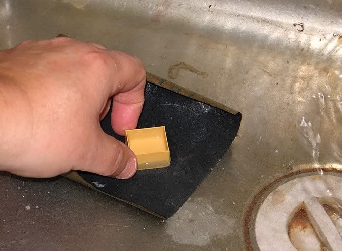

JUST A SIMPLE TIP that I thought would be obvious but I run into a lot of modellers that this never occurrs to .
To avoid all that 'cancerous' dust that will nail your lungs in the long term, I always sand my resin underwater. Suspect
I use wet and dry sand paper and sand in a shallow amount of water in my worshop sink. Thats my wifes hand. Smile
No dust and easy clean-up with the sink bottom providing a nice 'dead flat' surface.

An excellent tip that I have used for years! It is nice to see a photo illustrating it though. I started using this technique with vacuum-formed parts to keep the amount of polystyrene dust down.
My addition is to mark where you need to stop sanding. For this I use a pointed permanent marker (Sharpie brand is the one I use in various colors). I cover the bottom (undercut) edges of the part I want to sand free and this allows me to visually see if I am sanding unevenly so as to apply more or less pressure. A figure 8 motion while sanding helps but so does rotating the part in one's hand every so often.
On small, flat, or other hard to hold items, I use a piece of cellophane tape, longer than the piece I am sanding, and tape it with a raised loop in the middle to create a handle. By the way, I use this technique also when masking clear parts as it helps me lift the edges of any liquid mask I use facilitating its removal.
This is all old school modeling but it still holds true.
