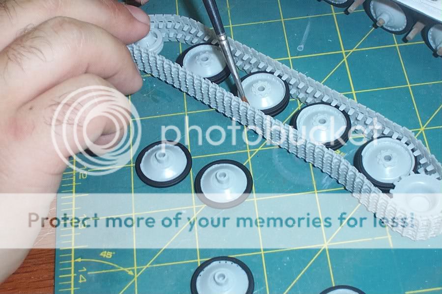

Let us begin then. Once again, as in part 1 and 2, you've prepped your wheels and cleaned your track links. However, this time the only parts you've assembled are your sprockets and your idlers. Further, you will need to build the tracks runs in two steps, a short bottom section and the much longer top/wrap around section. This can actually be done in two distinct modeling session as I did with this vehicle.

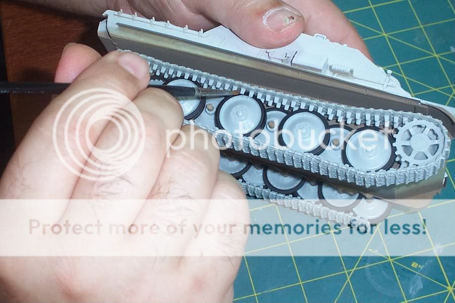

First you will need to paint the lower hull pan with your favourite/appropriate "muck" brown. Once this is dry you can mount your inner set of wheels. This time, unlike preceding ones, you must cement the wheels in place right away.

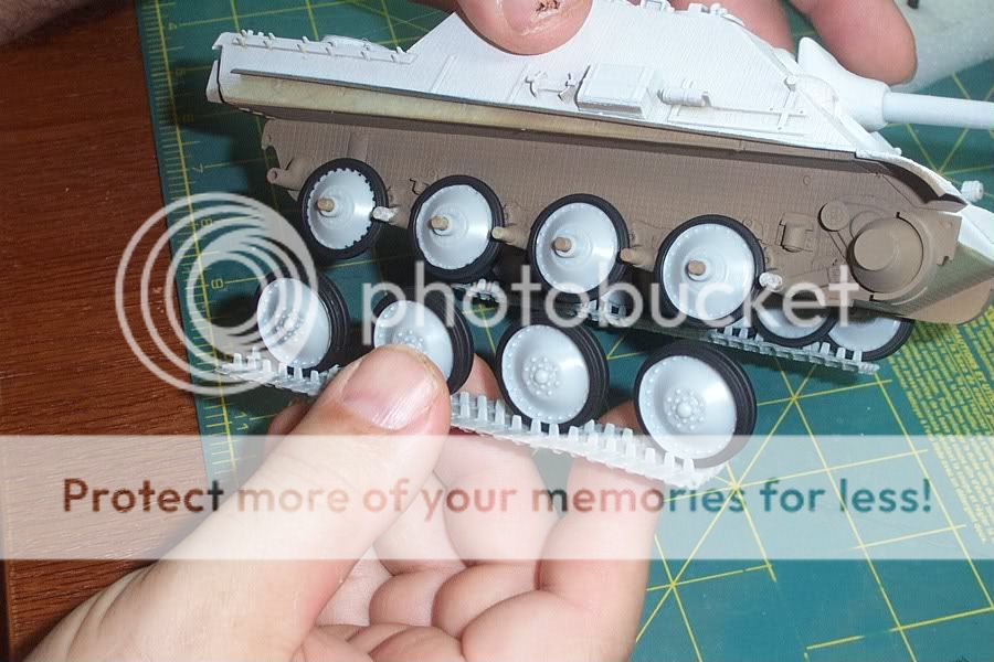

Next, mount your intermediate wheels (or final set for the Tiger ausf B [Kingtiger to most] family) on the appropriate axles using tissue shims if required. This done build your short run of tracks, using only enough links to reach the mid point of the front most well and the mid point of the rear most wheel Glue that track run in place; once set it should give you this.

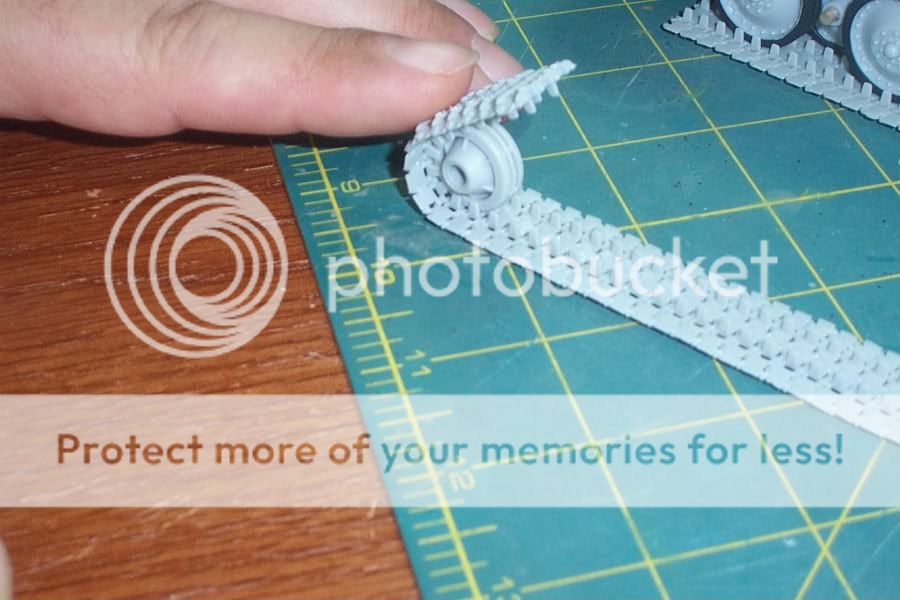

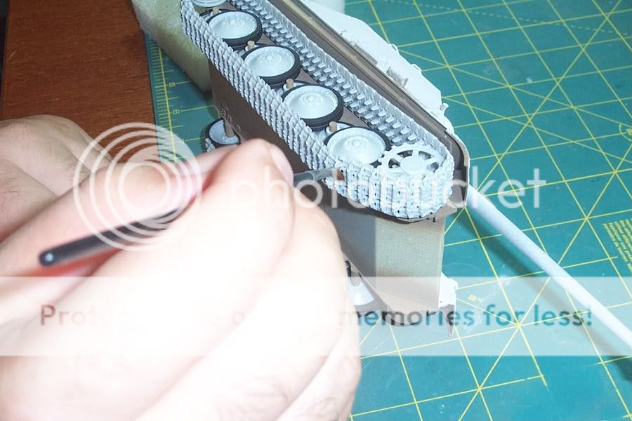

At this point, whether you've split the work or not, it's time to assemble the remainder of the track run from the links you counted out. Let the solvent set for about ten minutes, then eyeball where your sprocket and idler need to go and wrap the ends of the run around them. Don't worry if your a little off, the track is still very workable.
It's now time to join both runs together, front and back, and cement them. Again I prefer a slow acting solvent here as you may have to fiddle some with your tweezers.
At this point, glue the top of the middle wheels (final ones on the Tiger ausf B) to the track run. Be very careful not to get any glue on the inner set of wheels as this would ruin the whole exercise.

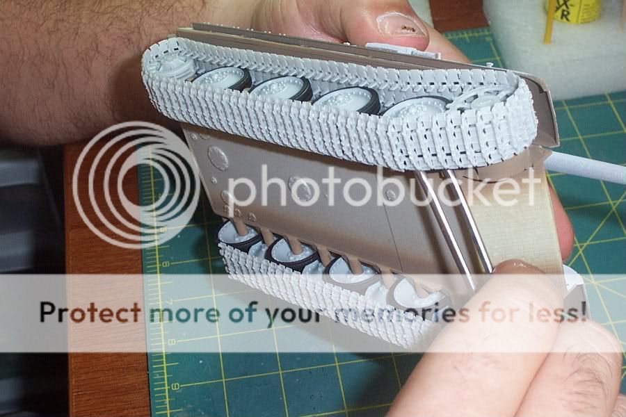

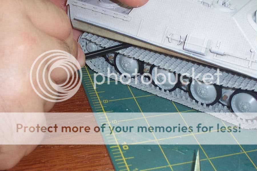

Using a brush handle, press down on the top run of track to make is sit as appropriate to the vehicle your are modeling

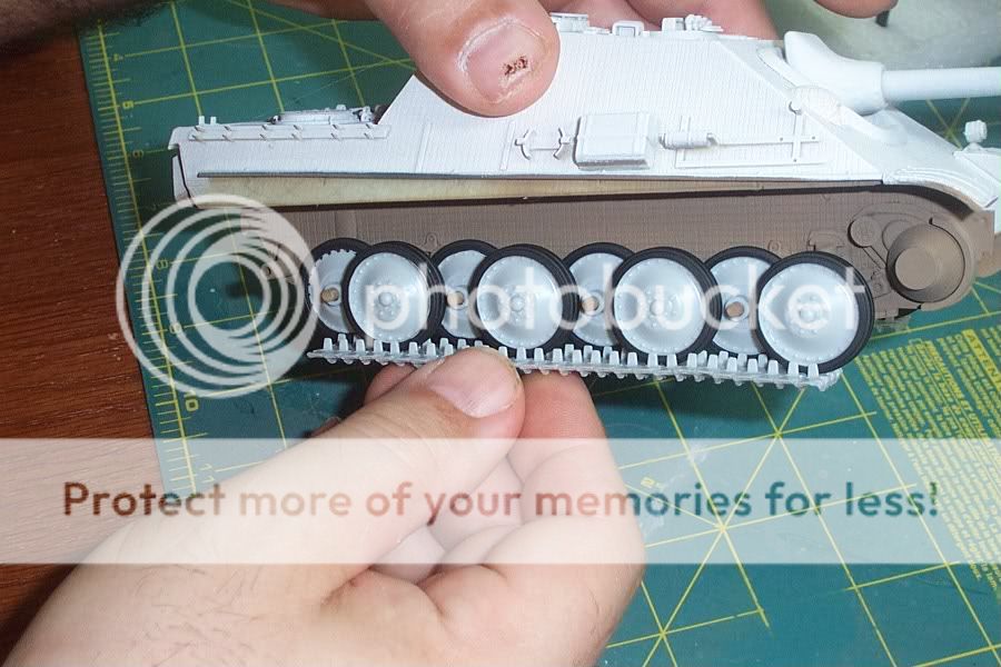

Fit the outer wheels (Panther, Tiger ausf E families) but again do not glue them on. Use more tissue "shims" if they are loose on the axles.

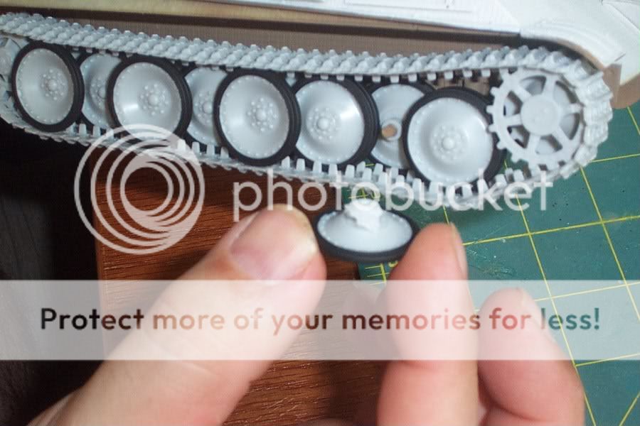

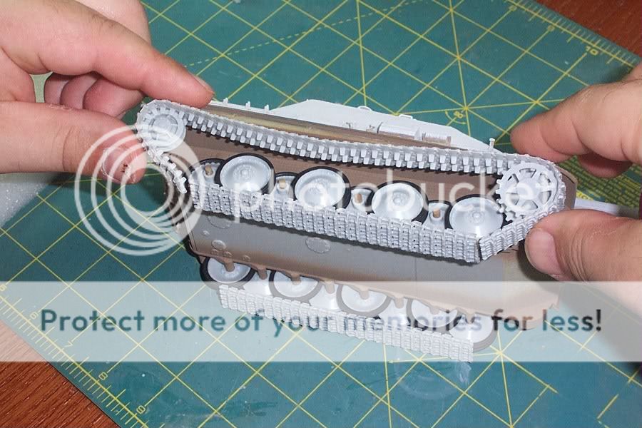

Once the model sat for 12 hours (or overnight), gently, carefully pry the track run off the vehicle after first removing the outer set of wheels. Once the run is off, apply more solvent to the back of the assemblage, just to be on the safe side.
Store the track runs on the vehicle to avoid the evils of shrinkage. You need not mount the outer wheels on at this juncture.
