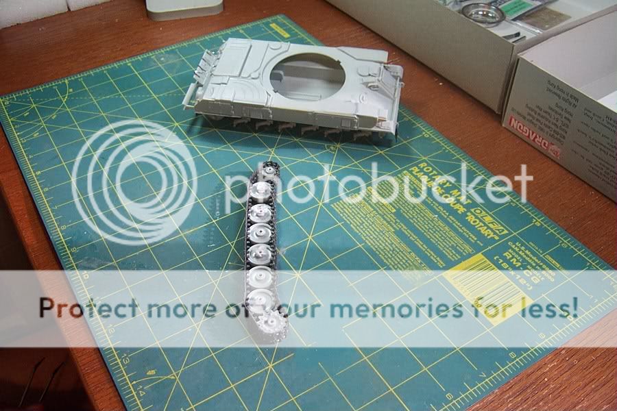

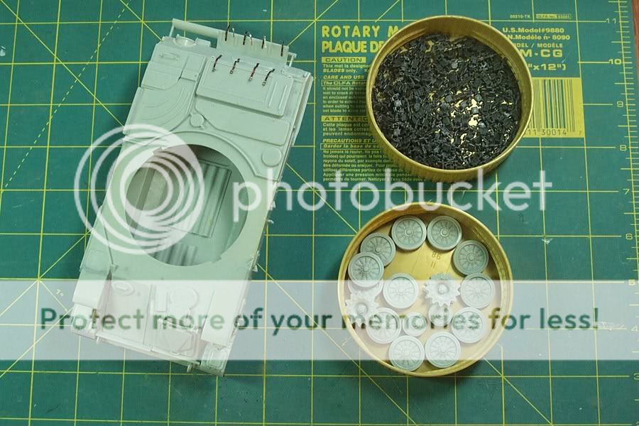

Okay, so your wheels/idlers/sprockets (henceforth "wheels") are assembled, your track links removed from the sprues and cleaned up.

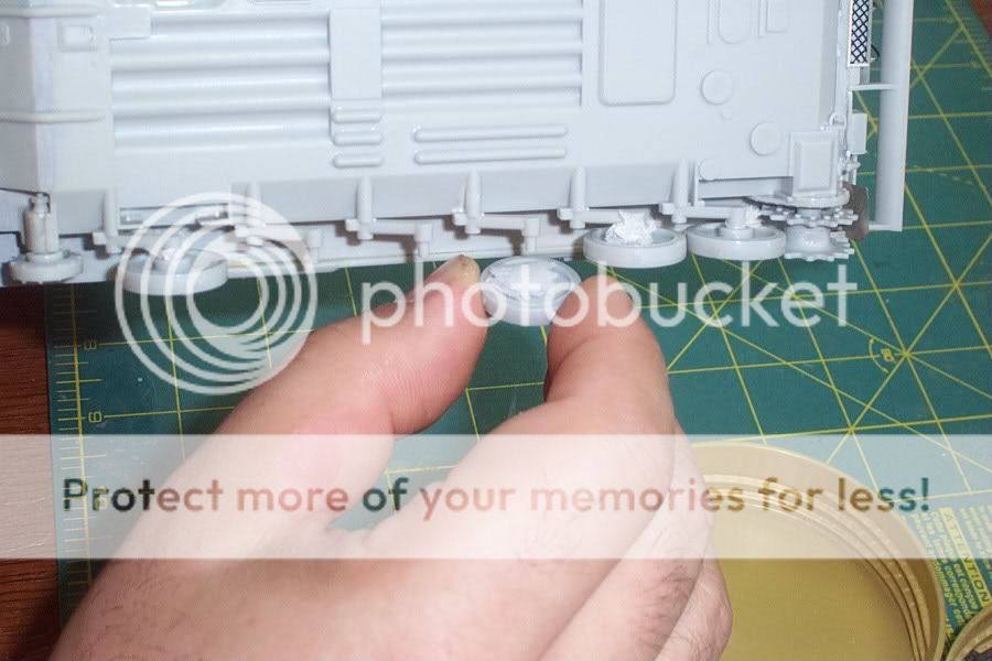

The very first step involves fixing your wheels to the model without any glue. Often the wheels will be too loose on their axles to stay in place, a small piece of tissue paper will help hold them in place, as shown here.

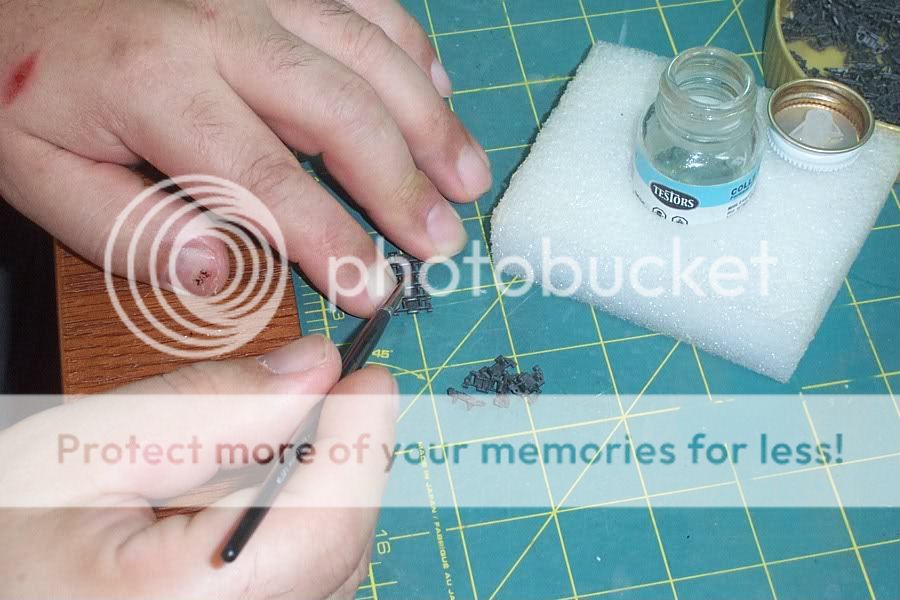

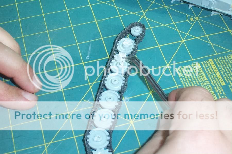

The next step involves assembling the track, working in short sections until you have the whole length done. Use a slow drying liquid cement such as Testors here, as it will afford you plenty of working time.

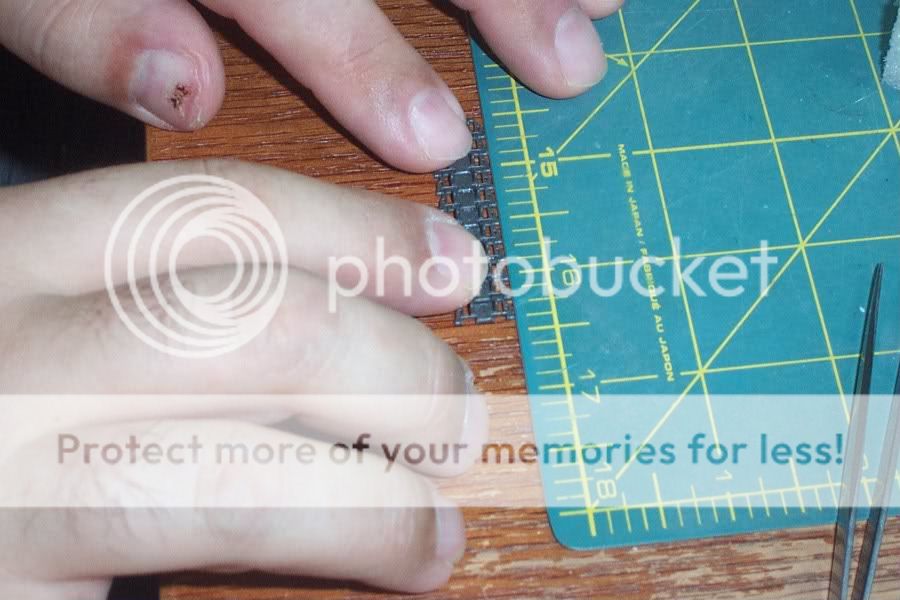

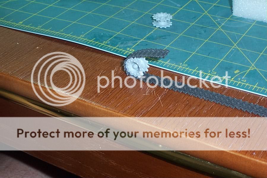

It is fairly imperative to keep your track run as straight as possible. Make yourself a jig out of K&S metal profiles or basswood or use any available straight edge as I have done here with the edge of My cutting board.

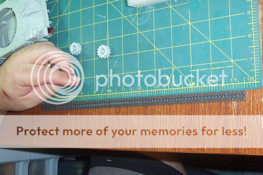

Okay, now your whole run is built, you gave it about ten minutes for the solvent to weld the plastic sufficiently while still allowing flexibility. Since you need to negotiate the fender/hull of your vehicle, it is best to apply the sprocket to the tracks rather than the reverse.

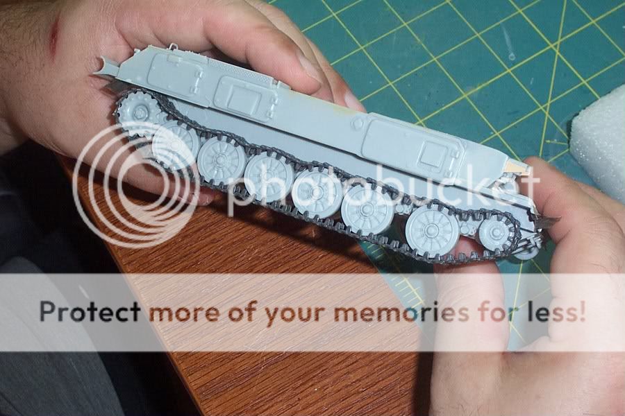

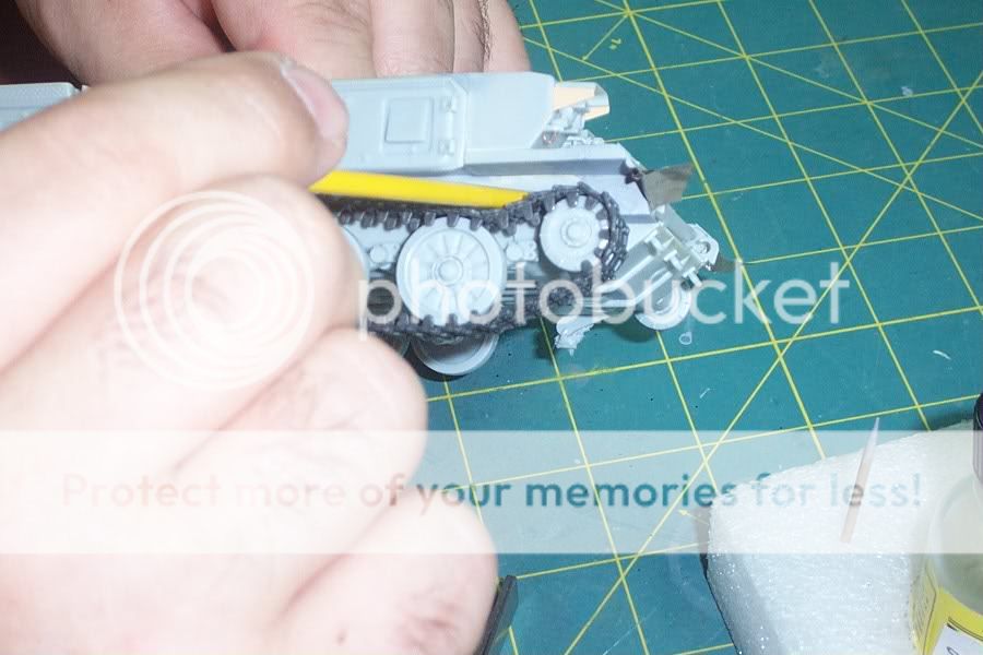

Now come the most fiddly step. Slip the sprocket onto its axle and bring the track run in place. This done glue the bottom of the wheels into the lower track run. Here I recommend the use of a fast solvent such as Tamyia's Xtra Thin or Tenax7R, then bring the forward section of track over the idler and back toward its other end. Glue the ends together

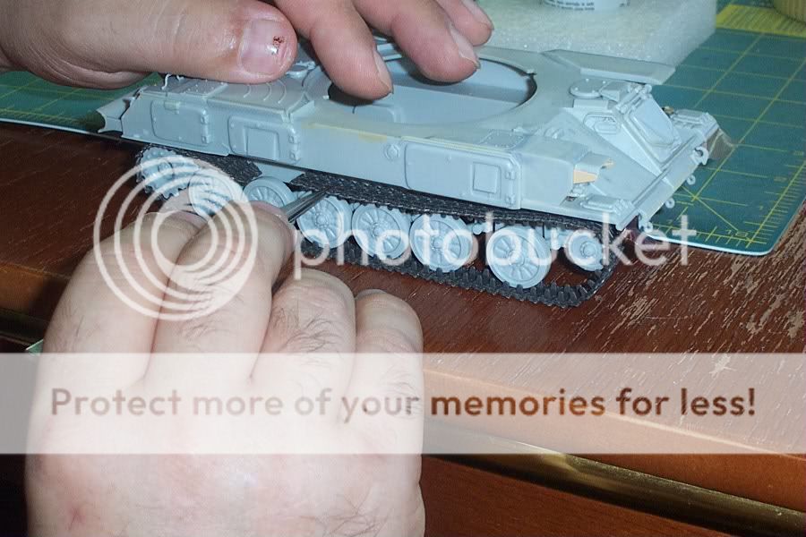

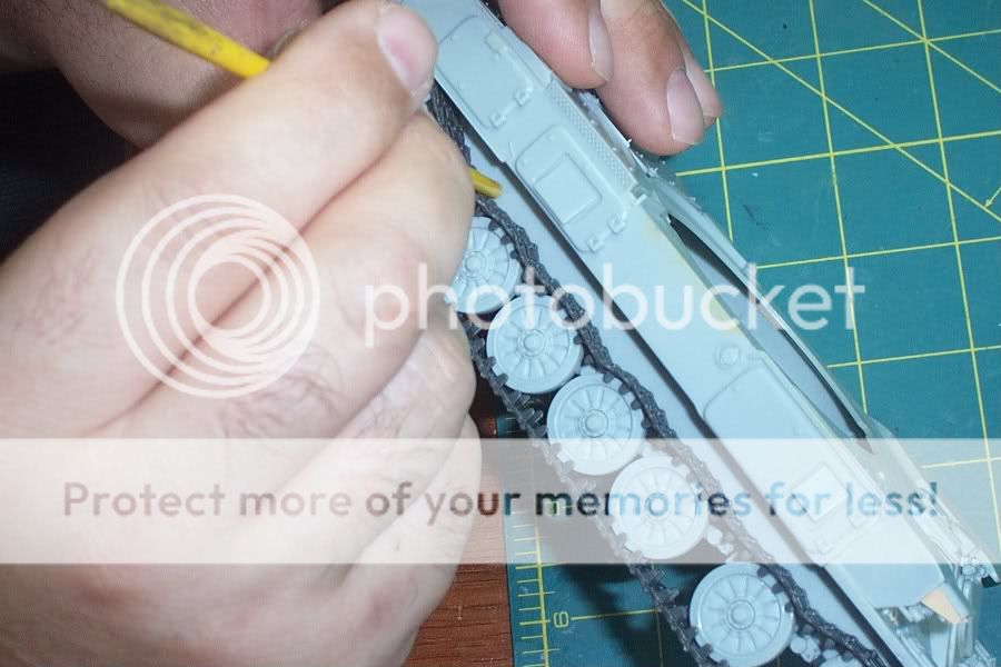

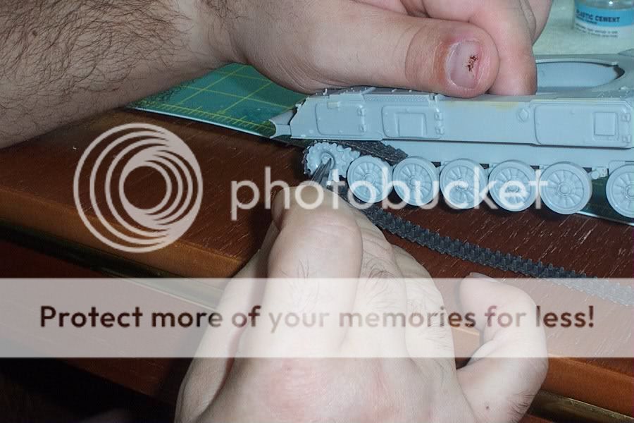

Next, induce whatever amount of sag you planned for when you counted out your links. The simplest way to do this is with the back of the handle of your glue brush.

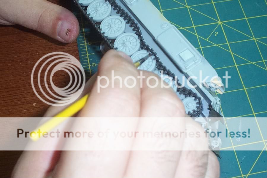

Once again using the fast acting solvent, glue the track run to the top of each wheel as you go.
You are now basically done. Tweak the adjustment of your sag if needed and let this set overnight or at least 12 hours.

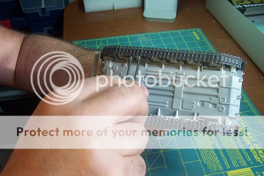

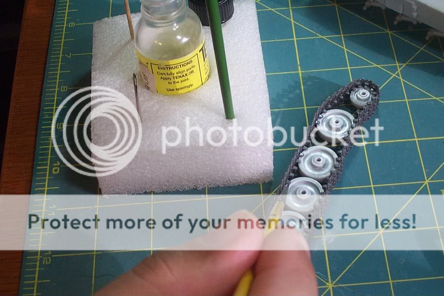

Twelve hours later, remove your assembled track run. You may need to pry it gently off the axles, using the handle of a brush or some fat angled tweezers as I did here.
Now remove your tissue "shims" and glue the backside of the run to the wheels (for insurance) with fast acting solvent.
Now you're done. Put the whole run back on the vehicle and let it set another ten to twelve hours. For the next week or two as the solvent outgasses it is best that your store the track run onto its axles, lest shrinkage make it suddenly too tight to fit back on.
