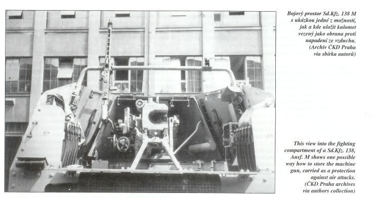

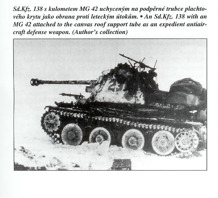

This is going to be real good to watch. Also I am very interested in the MG34 mounted? on the second photo, number 27 ? Cool

G Cooper wrote:This is going to be real good to watch. Also I am very interested in the MG34 mounted? on the second photo, number 27 ? Cool
Yes, it's an interesting question. I suppose this is a field improvisation, so I'll try to see the mount in a picture but the logic says it seems the mount was welded to the roof of the superstructure. If I see it in a picture I share it in the forum, don't worry.

Post  Richie on Thu Feb 05, 2009 7:36 am
Jose ,
I am pretty sure I have seen the MG mount attached to the canvas hoop , will try & find a picture for you .

Post  Richie on Mon Feb 16, 2009 10:10 am
Jose A. Azorin wrote:
Richie wrote:Jose ,
Looking forward to seeing the build !
Richie
It would be very appreciated. Thank you very much, Ritchie!
With regard to the building, I'll build it very slowly until I finish the King Tiger, then I'll work quickly.
Jose ,
Sorry for the late reply with the information , I presumed I had seen the pictures in Nuts & Bolts 18 but having searched through the book again & again , I was beginning to think I had imagined seeing it ! Very Happy
I finally found some pictures in "Marder III & Grille" by MBI publishers !
This mentions that it is mounted to the canvas hoop but the caption names it as an MG 42 where it is clearly an MG 34 !
The close up photo which I thought was the hoop of a Marder IIIH was a Marder IIIM , I am thinking that it would be a unit based practice , I imagine & I believe the top photo supports my opinion that they may use a MG rail mount similar to what is used on motorcycle sidecars .
I hope this helps Jose
Richie

Post  Jose A. Azorin on Tue Feb 17, 2009 7:49 pm
Hi Richie,
Thank you very much for the pictures. I knew the last and it is a Marder III M. Its bar is thicker than Marder III H, this way I also think they use the mount of a sidecar or so.
THANKS AGAIN, Richie
