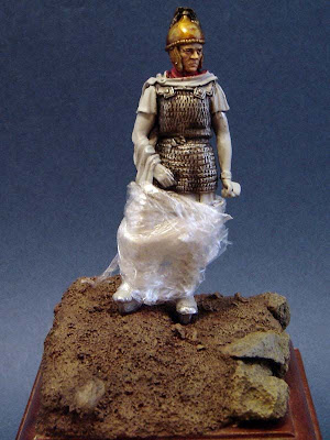

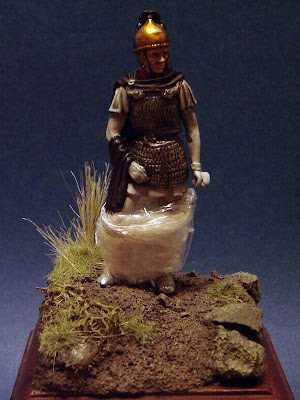

Reading Jenny's great tip about painting pedestals for figures reminded me of something I like to do when painting figures.
I tend to get up close and personal (No! Not in that way!!) with my figures when painting, and sometimes I find a pedestal or mounting block too chunky for me to comfortably handle (it's a personal preference). Unfortunately this means I handle the figure a lot, and with that comes the body oils and sweats secreted by hands and fingers which has a negative effect on acrylic paints (i.e. they rub off!).
So to cut what could be a long story short, what I do is wrap the (assembled) figure in cling wrap (seran wrap?), and then as I paint from the top down simply peal the wrap down, not unlike peeling a banana, as I move along. I do confess the idea is not my own, but I don't recall who I learnt it from.
Pictures follow. This is a (unfinished - there is no other sort for me) EVD 54mm Sertorian Legionary I started Jan '08. Unfortunately I didn't photograph the figure completely wrapped (or maybe I did, I'll have to check), but I think you will get the general gist of what I mean by the two pictures below.
HTH, any questions or comments: shoot!

Nice tip Tarok.
I'm not sure I would want to use it for 1/35 but this should come very handy with larger figures.
Thanks!

Thanks for looking and commenting Richard. Actually a 54mm size figure is only 4mm bigger than a 1/35 scale figure (which should be 49-50mm) so it's pretty easy to use this technique for the latter sized figure as well. I will admit that I don't use this trick on Warhammer sized figgies though.
Rudi Smile
