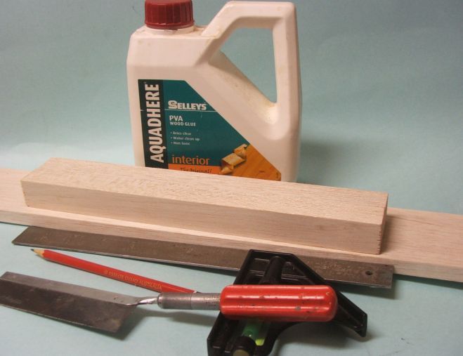

Very simple really , you will need the following .
First you will need two pieces of Balsa one piece square section 2.5 x 2.5cm (this will do up to a 1/35 scale figure easily . the next piece needs to be approx 3 x as wide & I am using a piece 7.5cm wide & it needs to be as thick as possible , I am using a piece 1.25cm thick . This second piece will form the base when you are letting the figure dry , so the thicker the better as when painting Pewter figures it will form a secure base .
You will also need some PVA adhesive , a razor saw , a set square & a pencil

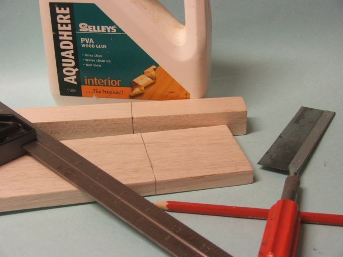

First measure the square section off into sections about the width of your hand grasping the piece , my hands are little but for Richies use these are measured off at 10 cm long ( try not to make them too tall or they will tend to get top heavy . Measure the base off so it will form a square ( ie. my pieces are 7.5cm wide so I made them 7.5cm long )

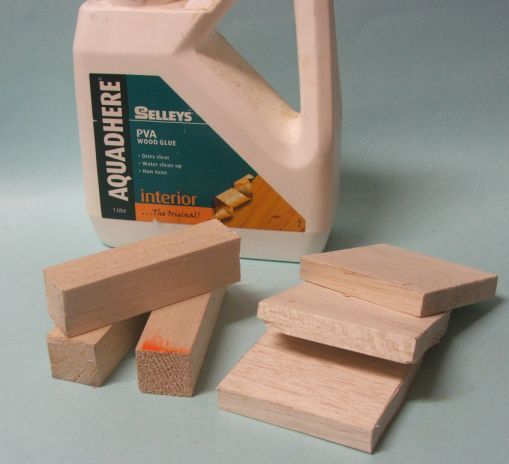

Cut as many as you need , we would have 25 to 30 I guess . Depends how many figures you have in the process of being painted at any given time , you will want to make as many as the amount of material allows you .

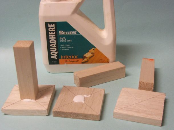

Put a blob of PVA in the centre of each base & attach the square section so it forms an inverted T . You will notice I also drew diagonals on the base plates so the pedestal is alligned centrally . Wipe off any excess glue with a wet rag .

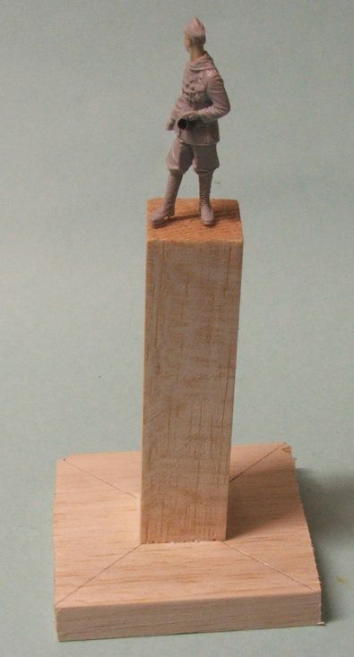

When you have pinned your figure , just push the pins firmly into the base . You can now undercoat & paint your figure without touching it ! For detail painting the pedestal is a handy hand hold & the base makes the figure stable to take a break for any length of time .
Once finished , put the pedestal in a dust free area with the figure on it until it is ready to be transfered to its display base . Keep the base handy for your next figure . After a hundred or so figures the holes in the top may make the base a bit wobbly for holding figures , get the razor saw and cut a centimetre off & Voila , a new one !
