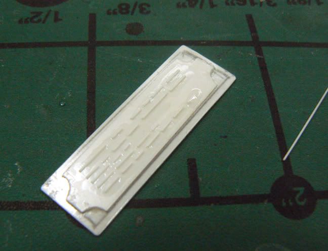

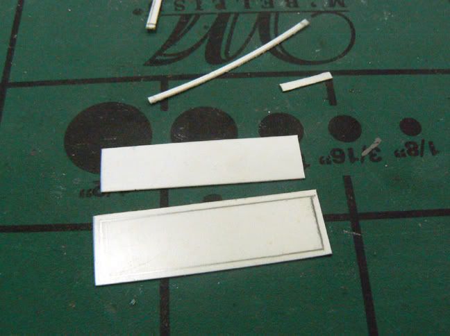

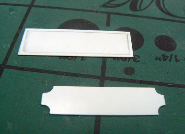

I First I am going to show you how to make a simple text plaque. I started with two small pieces of plastic, one about one millimeter smaller than the other.
Using my home made punch & die I cut some round corners of the smaller plastic piece.

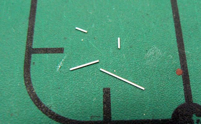

Next, I cut a few pieces of 0.3 mm plastic rod in different lengths.
I glued these rods to the plastic, and using a similar method to the one used to make weld lines I textured the rod pieces to resemble words.

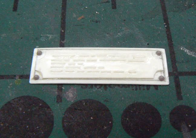

Four round bolts from Bronco completed the plaque.
Here it is painted.

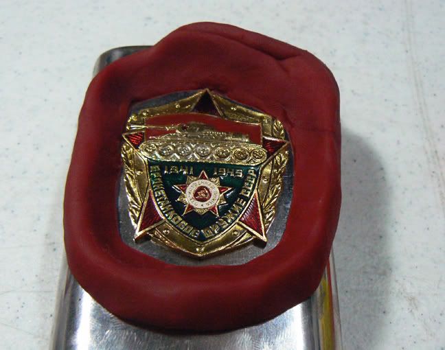

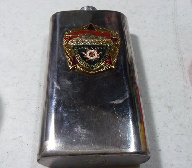

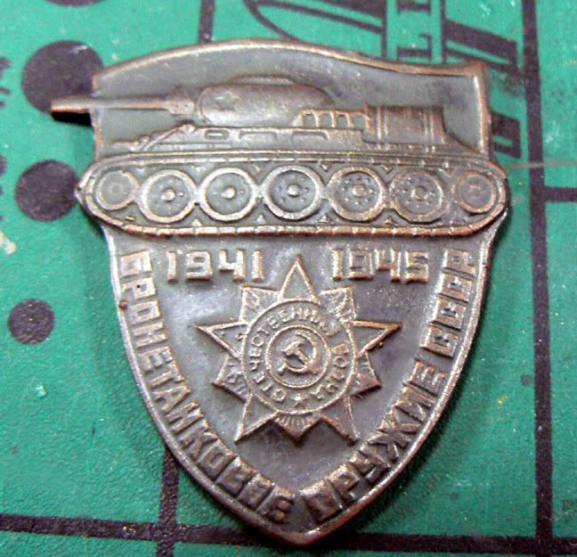

For the large plaque, I started with a souvenir I got some years ago in Europe.

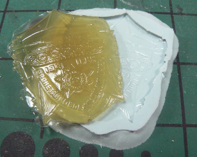

I got ready to copy the emblem. I used play dough to make an improvised mold casing.

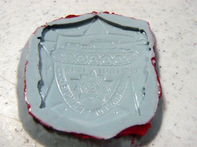

The silicon rubber was poured and a mold was made.
Here is the resin copy.

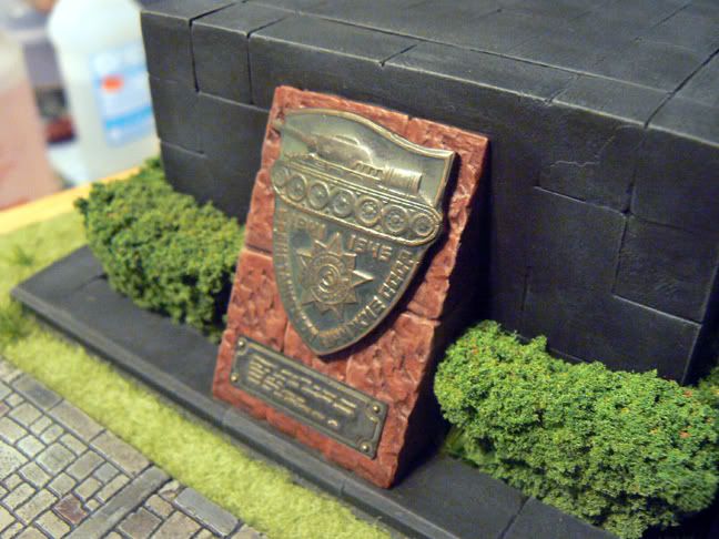

And finally both of them in place.
